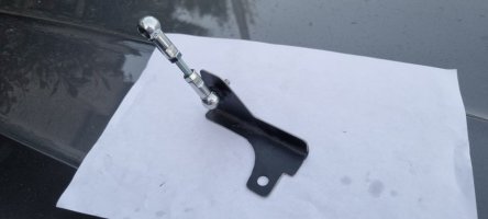

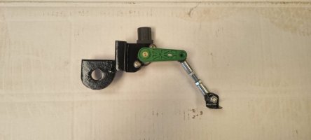

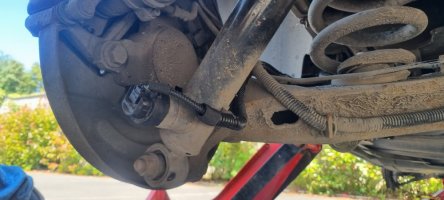

I made up brackets and tie rod for my front left level sensor.
Also made one bracket for my rear level sensor to be transferred from the RHS to the LHS.

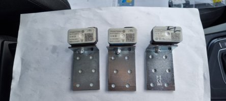

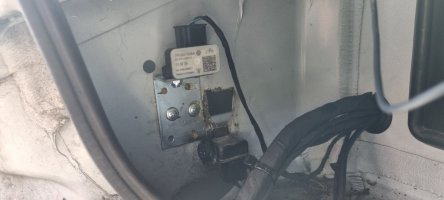

Three bracket for my acceleration sensors.

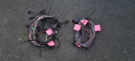

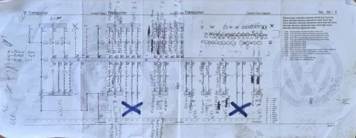

Bad news is that I thought that my DCC loom is from T6 but as it turned out it is from Sharan.

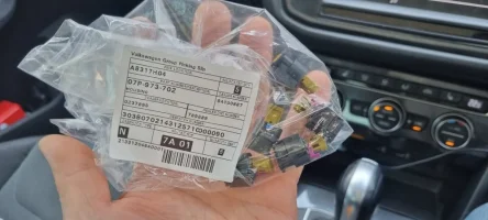

I need to adjust the length of some sections and replace shocks connectors.
All external work completed successfully :D

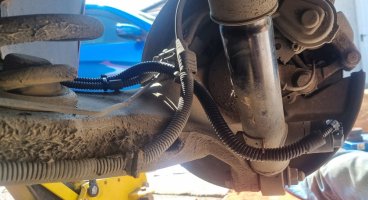

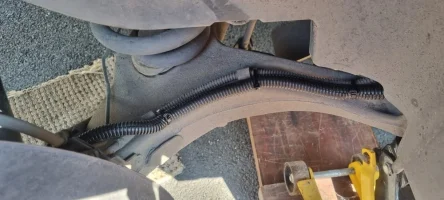

Sharan loom modification turned out to be a very time consuming task.
I have tailored it perfectly to match my bus and got it wrapped with TESA tape.
I also added protective conduit where extra protection was necessary.

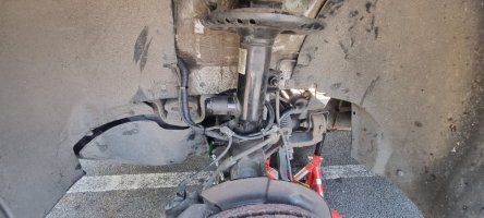

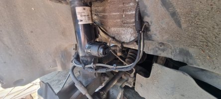

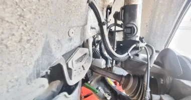

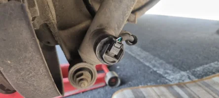

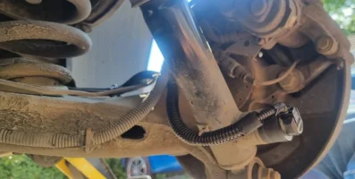

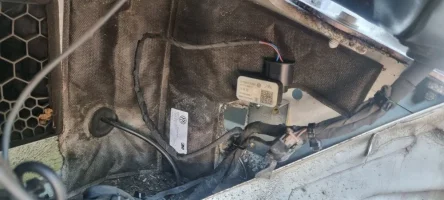

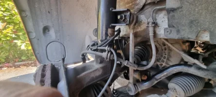

Front acceleration sensors.
Front right.
20230604_134934.jpg20230604_134942.jpg20230604_134946.jpg20230604_134953.jpg20230604_134959.jpg

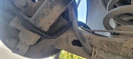

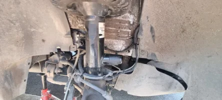

Front left.

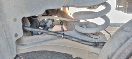

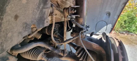

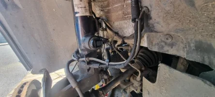

Rear right.

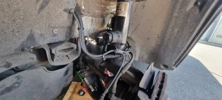

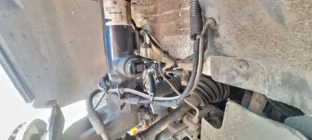

Rear left.

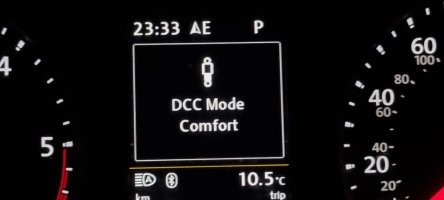

Happy driving in the comfort,
comfort mode to be specific :D

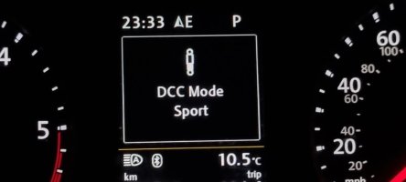

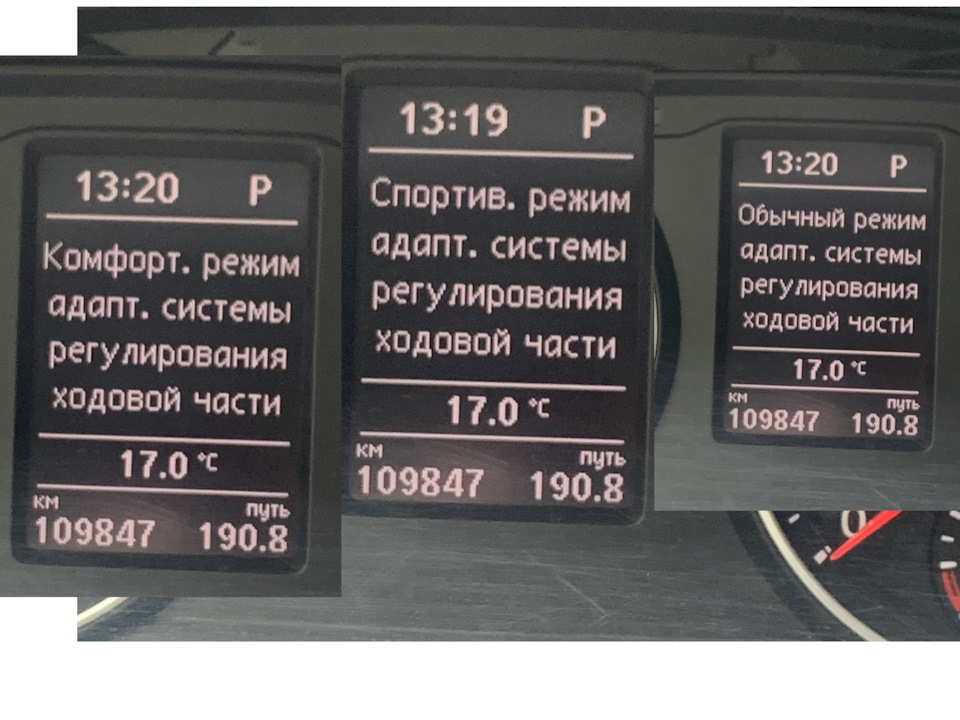

NORMAL MODE:
SPORT MODE:
COMFORT MODE:
