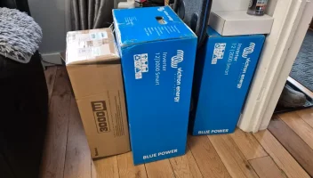

So after liking over the options...
I went for..
Yep, back to#team blue.
3000va, 2400watt continuos.
130% overload for 30mins
6kw peak starts.
N-PE bonded option.
But needs 90mm2 cable for 0-5m
Or twin 70mm2 - jeez
Recommended battery bank is 400ah.
So we have also ordered a second sb230 gen 4 to go under the passenger seat .. that gives me us a 460ah battery bank. From the guys over at @RoamerBatteries
