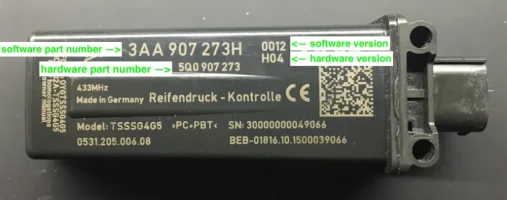

A bit of update.The following components appear to be compatible with PQ25 platform.
Control unit/receiver (auto-location)
3AA907273D
3AA907273F
Sensors
3AA907275
3AA907275B
3AA907275D
3AA907275F
I have never used non OEM sensors so assuming they are compatible,
where did you locate your controller/receiver?
HW part number | HW version | SW part number | SW version |
5Q0 907 273 | H06 | 2H6 907 273 | S0003 |
5Q0 907 273 | H04 | 3AA 907 273 B | S0009 |
3AA 907 273 D | H09 | 3AA 907 273 D | S0010 |
5Q0 907 273 | H04 | 3AA 907 273 F | S0011 |
5Q0 907 273 | H04 | 3AA 907 273 H | S0012 |

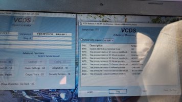

Can you show us what is available on your CAN Gateway Installation List?As I cant get indirect TPMS working with vcds on a T61. Im wondering how difficult the direct TPMS would be :/
