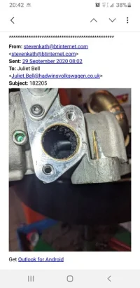

so had the usual EML on recently and cleared the fault only for it to return as EGR Cooler low flow.
Booked it into my local Vw car dealership south Lakes Hadwins.
They ran the diagnostics and came to the same conclusion that the egr valve and cooler needed replacing. They didnt bother going down the cooler flush route.
Went to VW warranty and they said they wanted internal proof the EGR wasnt blocked with carbon before they would approve the replacement. So I had to gamble 2 hours labour to see if it was blocked or not (see pic below).
Vw approved it and changed it which i was quite suprised about know peoples struggles on here. I also had the squeaky aux belt and tensioner which i knew was under a service bulletin, first they said they would do it under warranty then went back on it and said it doesnt cover noises, bit ridiculous.
