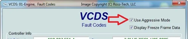

Worth noting that VCDS has two different modes to scan the faults.
The trick is that VW tester ODIS uses "non-aggressive" mode which e.g. doesn't show your P204F fault (no freeze frame data any more). Also the current P20EE will be beyond their reach after approx. 300 km's - the ECU makes it fade away but fortunately keeps updating the frequency counter.

Would you suggest I only do the non aggressive scan in future?
Non-aggressive scan shows only "active" faults, or very recent ones. Just good to know that only these are seen at VW garage.
The non-active faults are more just a history log - possibly long-term early warning kind of thing.
I would keep on doing aggressive scans - more is better :thumbsup:
