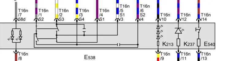

I don't like the shape of this Passat NMS switch.
Also there is no surrounding trim so it might be hard to mount it in position and make it look good.

I don't like the shape of this Passat switch.
I always loved my EPB in my Sharan 7N, (location, shape, width and its functionality)!
I don't know if I am going to succeed but I already bought one.
Electronics in these two are different but I am going to try modify it anyway.
Passat NMS switch E538 below.
Sharan 7N (2011–2015) & Tiguan 5N (2007–2015) switch E538 below.
Not so easy but I think my desired modification is possible :thumbsup:.
  • Love
Reactions: mmi

Yes indeed, Tiguan AD1 EPB switch is electronically identical to the Passat NMS unit :thumbsup:, thanks again!
Also pinout numbering seems to be the same:grin bounce:, so the plug could be direct match :whistle:.

Great then you got your Sharan Switch :)
I think I am starting to be lucky, which is very unusual for me.
Initally I was intending to buy Sharan EPB switch. Went ahead and bought one but when I got it I realised that it actually is a Tiguan variant:grin bounce:.
Seller has messed up his listing and put incorrect description, what a coincidence :D.
