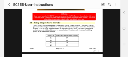

The Sargent has a internal power supply.
13.8v at 12A
So that voltage might drop to 12.2v by the time it gets to the battery.
So not much chance of overcharging a battery.
13.8v at 12A
