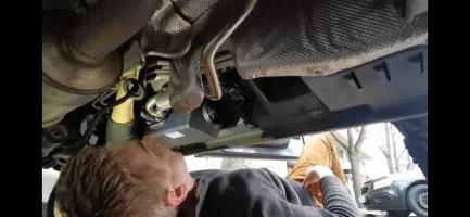

I am in the middle of the second such installation on my T6 - as you can see I was on a driveway yesterday...
Yes, it is absolutely possible to do it on the streetside. If you drive with your both front wheels on the curb, it will be even easier.
The hardest part (but still easy) is to take off both right and left mudguards.

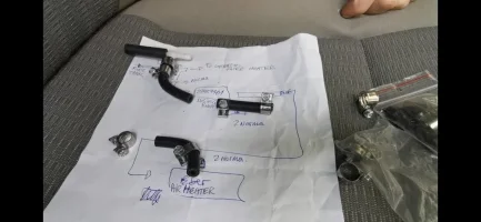

Here's the schematic of the fuel line (and a hint on the fuel line parts needed, in case you are making a kit yourself :cool:):
Heater install is about 30min job including the mud guard removal.
Another 30min for the fuel line.
And several hours for the cutting work for the air vents in the body and trim.
