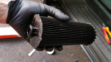

And in case you're interested, here's the insides of a filter after 220 000 km.
