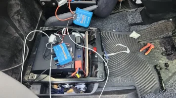

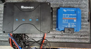

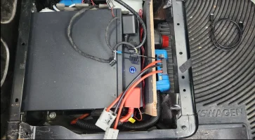

well rip out the trusty old

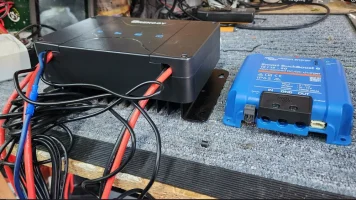

Renogy DC50S DC-DC charger . . . and swap it for the Vic XS.

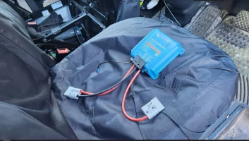

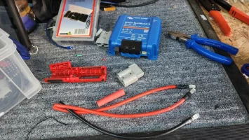

on the bench you can see the size difference, ,

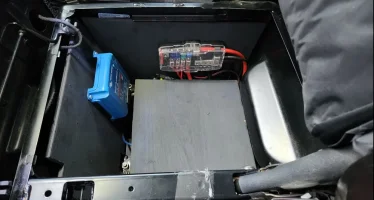

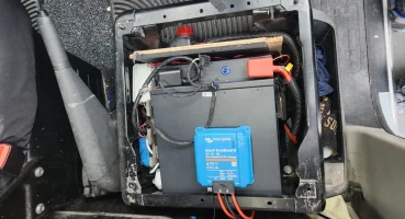

time to make up my normal 50A Anderson connector for power IN & OUT plus a BCM Eng Run feed (+IGN)

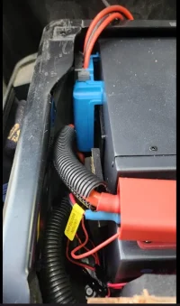

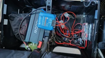

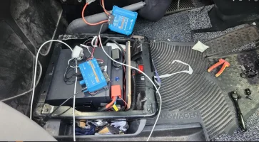

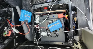

back out to the van. . .
its tiny compared to other units. . .
the closest thing is prob the new small Renogy or the Auz REDARC.
