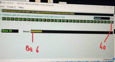

I have coded most of it but no i need some more help. In a post earlier, BCM09 should change byte 29 bit 6 to 1. but this is how it looks with me
Bit 6 is actually second 0 from the left (binary counts from right to left and 0 is classed as a number in a computers mind) change the 0 to 1 and press enter or alternatively change the decimal box to 40 then close the box and click "Do It" as usual and should work matey
