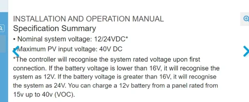

Cheers again @Dellmassive for the response - what should I be looking for? Should it handle the total voltage of all panels when added together.
Just noticed on page 1 of that instruction manual though:
"Maximum PV input voltage: 40V DC"
@chearmstrong
lol . . . dont know how i missed that.
as you rightly say, PV input is 15-40v . . . and 15A max
so you might be good for up 200w - 300/400w
INSTALLATION AND OPERATION MANUAL
Specification Summary​
• Nominal system voltage: 12/24VDC*
• Maximum PV input voltage: 40V DC
*The controller will recognise the system rated voltage upon first
connection. If the battery voltage is lower than 16V, it will recognise the
system as 12V. If the battery voltage is greater than 16V, it will recognise
the system as 24V. You can charge a 12v battery from a panel rated from
15v up to 40v (VOC)

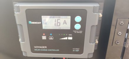

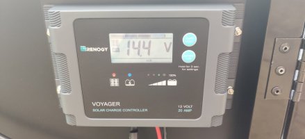

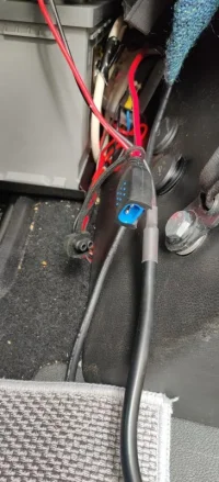

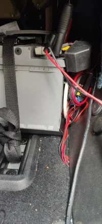

My Renogy suitcase has arrived! I ordered a 6m extension also, so I can site the panels out of the shade if needed.
The pack comes with croc clips but I may see if I can buy a set of male Victron connectors and then I don't have to keep clipping on the crocs each time.
But so far so good, the nearly full leisure battery is taking 1.4 to 2.0 amps with output from the panels around 14volts.

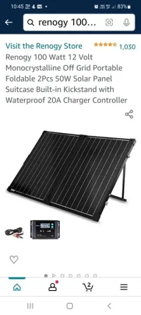

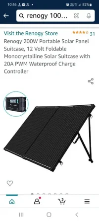

Yes you need a controller.
But you can buy panels allone, or complete kits.
Look at 100w-200w kit per 100ah leisure battery.
Short cut.
Buy the Renogy suitcase kit.
Either the 100w or 200w.
Eg.
Iv got both and can vouch for them.
Plug and play.
Just clip on battery.

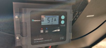

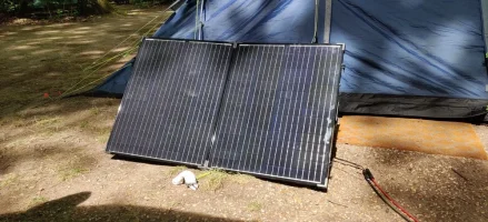

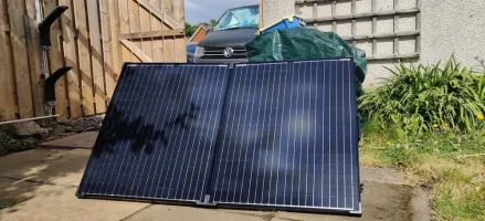

Here is my Renogy 200W suitcase kicking out 5 Amps off the French sunshine.
Just noticed that a lot of sun is reflecting off my panels. I'm reflecting power back... :-(

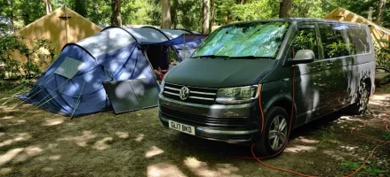

@Dellmassive yes, I kept moving it initially but after a while just live with the output variance.
The shade does provide relief from the mid 30s temps. The battery does get topped up though and after a while shows Battery Full on the display panel.
For me being used to the cool temps of Scotland the shade does help especially when it is near 30 degrees in the local town at night. This was after we returned to the campsite in the cooler countryside.

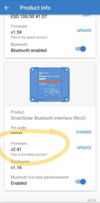

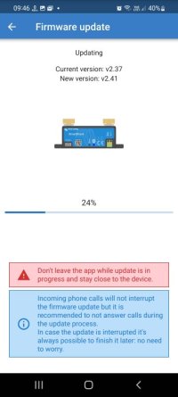

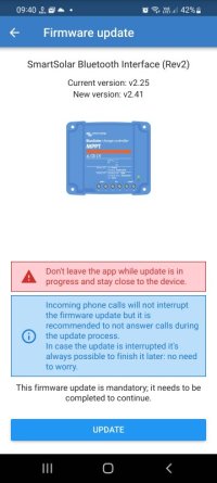

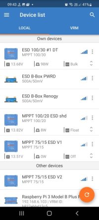

Victron 2.41 FW update brings in live data feed on the status screen....
:mexican wave:
Happy day's.
Screenshot_20220717-094754.jpgScreenshot_20220717-094630.jpgScreenshot_20220717-094020.jpgScreenshot_20220717-093152.jpgScreenshot_20220717-093125.jpgScreenshot_20220717-094310.jpgScreenshot_20220717-094242.jpg
