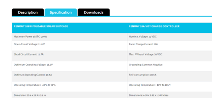

The Renogy 200w suitcase kit has a VOC of 21.8v
so as mentioned above it is compatible with the CTEK D250SE

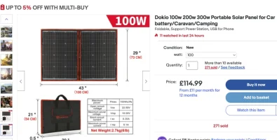

I've had one of these portable solar panels for a few years now. It came with a basic PWM controller and just crocodile clips directly to the battery. It served me well before I fixed 200w of solar permanently on the roof. However on really dull days, because it has its own controller it adds a very useful extra100w clipped straight on to the leisure battery.

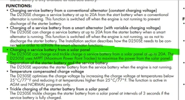

YES - the D250se has an internal 20A MPPT solar controller . . .

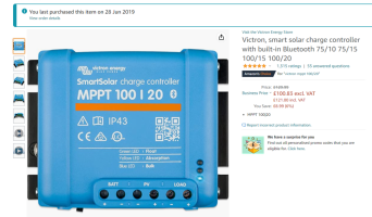

the recommended up grade for the solar controller is the Victron 100/20 smart - 20A
