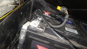

Thanks for the feedback - didn't quite expect that. Anyways, I'm confident VCDS Auto-Scan would have pinpointed the disconnect!Oh no....
It was just this, this unplugged cable.
I tried and it's working now.
