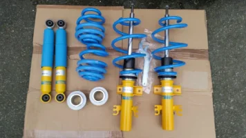

Hi Steve, Dutch T owner here and today finally we mounted your H&R ARB's for our T6.1. I would like to share my personal view and would like to ask for your opinion and point of view please, because you're for sure the most experienced one from us two, without a doubt.
Since 6 weeks been driving for the 1st time a B14 on a new T6.1 4Motion DSG while please note I'm not unfamiliar with coilovers and driving fast & lowered cars (my personal orientation is based on this background). Started our T6.1 upgrade project to make it worth driving (tyres, wheels, arb's and brakes upgraded), while we couldn't live with the oem set up delivered by VW . Meanwhile we travelled 3.000 km. Been also to Germany for a good test drive. Tested different ride heights and I must say that I am deeply impressed with the handling and the performance capacity of this B14 set when used intensively and my doubts about the rear spring are gone. It performs very well. Impressed by the big difference in comfort while only making a small adjustment e.g. 36 cm. front / 37 cm. rear compared with 37.5 cm. front / 38.5 cm. rear.
I'm not searching for comfort. I'm mainly interested in very good performance (in this price range budget we're talking here) while trying to make the Van performing as if it is a sporty car.....kinda
(hope you understand what I'm trying to say here). I drive this Van most of the time without (heavy) load, we have good roads and never a higher total weight of 2700 kg. For me and my personal driving circumstances this B14 set gives me more than enough comfort on the roads I drive combined with a stunning result in handling & performance.
What I kindly would like to ask you, the KONI/H&R set ; does it perform as good as this B14 set when really testing it to see where its limits are, keeping in mind my driving conditions and max. total weight ? Often more comfort usually means that it comes at the expense of driving performance ?
Would be very pleased reading your thoughts.
