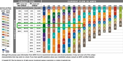

You should be able to get it all off SSC while you are at it. The diagram below shows the cable size required depending on length and current. Aim to be within the <3% voltage drop range. You need to allow for the positive run and the negative cable to the chassis. No need to allow for the return run through the chassis.

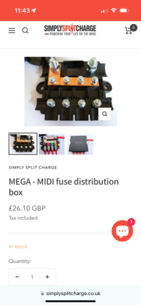

I used midi fuses where possible rather than Mega as they are much smaller. SSC also do a very handy fuse box / busbar which is a great way of tidying things up depending on your lay out (second picture). You can get the various ring connectors while you are at it. I’d buy a bit extra of everything to allow for mistakes and spare fuses to keep in the van.

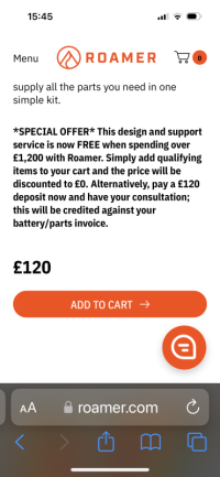

I went and had a look to find out about this free install guide from Roamer.
It appears to cost £120 now Wayne.
This is what site says. I’m only planning on spending £840 with them on my battery and ordered victron and cables etc elsewhere.
I’m not sure if this means the £120 will get taken off the price of my battery or only if I spend over £1200 with them?
Bummer, sorry Gord. Inflation I guess. I would give them a bell though and do a bit of begging, mention some fool of a member of the forum said you would get free advice. They are good folk!
