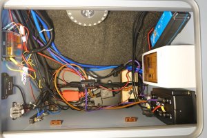

@Dellmassive Here you go. As I mentioned before, the electrical stuff is all in a cupboard over the wheel arch (with other cupboards on bothe sides and on top!) and space is pretty restricted. The pictures in order are RH side (with Victron Bluesmart, 240V Consumer Unit and Ctek D250SE), LH side (with BT2 and all the 12V stuff inc. diesel heater), the overall installation from above and closer in on the Renogy battery I kept the black and red plastic terminal covers from the old lead battery and the blocks of wood are there simply to take up the space left over from taking out the old battery which was bigger. I'll post again in a short while on the potential heat / ventilation problems.

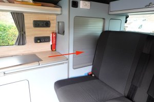

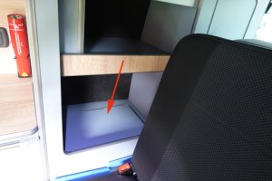

@Dellmassive . OK, here we go again. I've taken some more pictures which will hopefully illustrate how potentially difficult it would be to ventilate the cupboard with the electrics in. As mentioned above the cupboard in question is a 'black hole' built around the wheel arch with other cupboards on either side and over the top (the electrics cupboard is accessed by a hatch) and the R&R bed in front. That arrangement is what's always been there since the camper conversion was done 4 years ago. I've been giving it some more thought and I think I've now talked myself into relaxing a bit and leaving as is (but that's only my very amateur opinion based on limited knowledge of the subject). I say that on the basis that the van is not a daily driver and is plugged into the EHU almost all the time that it's parked up at home (and therefore the leisure battery is almost always kept fully charged by the Victron). We very rarely camp 'off grid' and almost always use sites with EHU. On that basis, the Ctek charger is really not kicking in very often to charge the leisure battery when we're on the move or, if it is, it's not for long as all it's doing is a quick top up rather than a longer charge. Also, on the occasions that the roof mounted 160W solar panel is charging via the Ctek built in MPPT, it should only generate about 8A max which would hopefully not overtax the Ctek too much. Anyway, where are the pics - feel free to burst my balloon (the red arrows are all self-explanatory). In order they're of top cupboard, cupboard open, hatch cover, the black hole with hatch cover off.
@Ayjay. All in all, that looks like a pretty good job done there. I am a long long way from being knowledgeable in this subject but common sense makes me think that you would probably be OK without adding any additional cooling or ventilation. In any case that looks like it might be very difficult to do looking at the constraints imposed by the location of the equipment. If as you say, the Ctek DC/DC charger is only called upon now and then and even then not for long periods, I would be tempted to try it for a while and see. Also remember that you have been using a similar set already for a few years without any issue until the old battery finally packed up. As I said before, I'm a layman in this stuff though and you would be better listening to the experts as and when the comments come in.
Just cut some holes and fit a vent ove the top.
One low down under the seat to let Air in.
And one higher up to let the warm air out...
If the vents are large enough natural warm air convection will help keep it all cool.
But before you cut any holes.... Id drop a BT temp sensor in there on top of the ctek to monitor how hot it get in there.
If it stays cool, then ok.
If it runs hot then cut vents in..

One possibility for ventilation would be to use a multi tool to cut a hole in the panel behind the ctek leaving just enough panel remaining for the ctek to hide the hole. Then on the other side of said panel screw a small metal vent cover and that should give the rear of the ctek the available air volume of the adjacent cupboard to dissipate the heat and still not look a mess.
Something like this attached with 4 screws in the adjacent cupboard.
@Dellmassive. Thanks as always. I actually ordered a couple of bluetooth thermometers earlier today with the idea of doing some testing. I went for a model that takes a CR2032 battery which are cheap and I've got loads of them. I actually had three of those little round ones (branded 'Oria') but when the batteries ran out and I went to buy new ones and realised that they cost almost as much as the actual thermometer did in the first place. On your suggestion for ventilation. I'd already thought about the low and higher air holes but the main problem with it is that the sides of the RnR bed are solid so the whole thing has got the removed before the holes could be cut and that pushes it into the 'far too difficult' category (but I recognise that it might be the very last resort!).
@Bigsidavies. Thanks for the suggestion but the problem is that the cupboard next door gets full of stuff when we go away for any length of time (which we do for 5/6 weeks at least twice a year).
