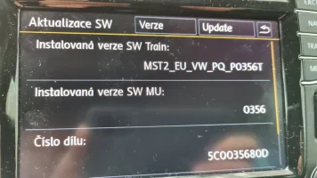

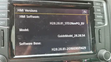

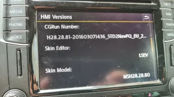

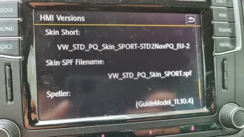

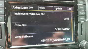

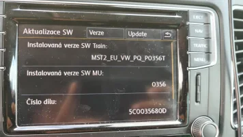

Hello, I am new here... Can you help me? I would like enable some codes and functions as voice, car menu etc. in my car. How I can do it? (without autorized dealers) Thank you very much for any informations. I can only activate offroad screen with pressed voice+menu+nav. John
Hi Jan,
What's your HW and SW version?
Ideally full VCDS info read would be handy.

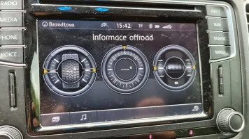

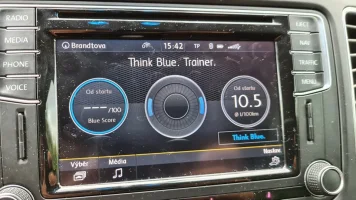

As promised, an update:
Performance monitor activated, vehicle status already showing as "active" in the lists as per previous posts. However, the gauges all display 0 readings, as does the steering angle on the off road mode.
New menu items, then click into each spoiler to see under that menu
I've also posted an admap of the radio for anyone whos interested!
Finally, I'm trying to work out where the radio gets thedriving data from, if its the gateway or the clocks. I think its the clocks, so I'm working on finding a set of 3D clocks to pair with it and hopefuly get everything working.

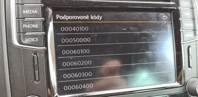

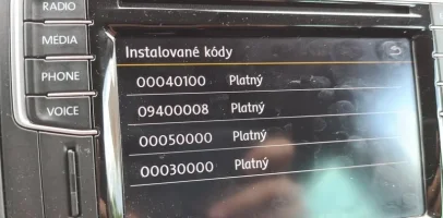

Hello, how I can activate Vehicle Data and Driving status?
You could check with your local VW dealership and see if they can activate 60100 - Vehicle Interface for you.
My local dealership was useless in this respect.
Alternatively ask @Jester and I am pretty sure he will have a solution for you.
Reactions: mmi
Thank you, I am far from any dealership but I try ask Jester :)
John
