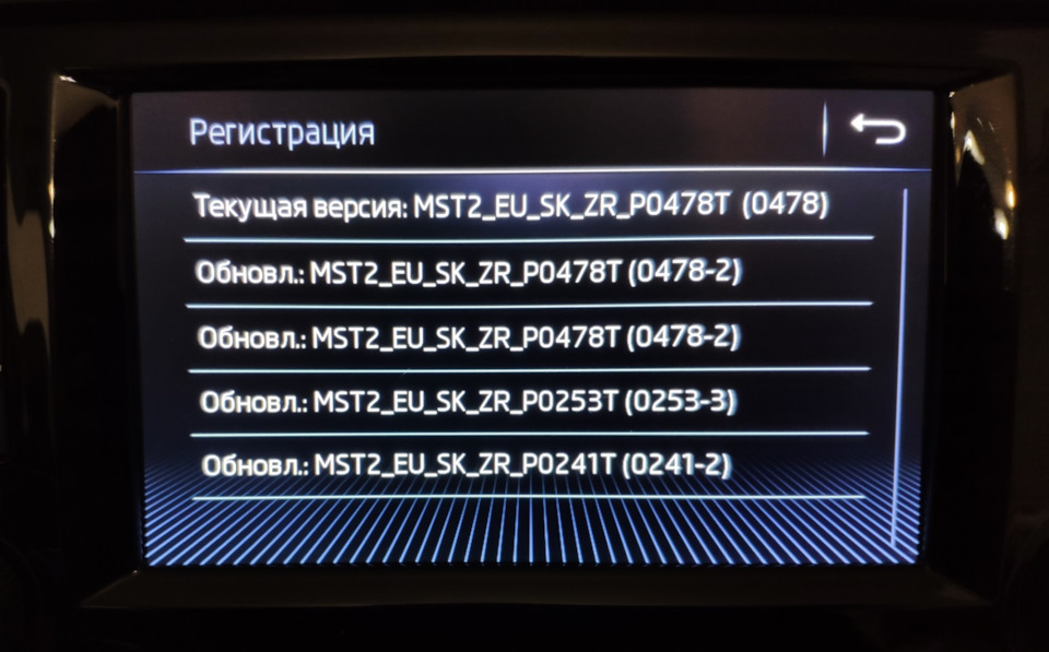

Done it with 3 Units. You can update from 02xx to 04xx! But you have to modify metainfo2.txt and swdownload to enable this.
Don`t waste your time with transfering themes from 0478 to older firm as older can't handle most of features. So only way is to update to 0478. Every Unit with train of 02xx and 03xx can update to 0478
What exactly would need to be modified in "metainfo2.txt"?
Release version, MUVersion, TsdBuildNumber, Checksum(s)?

I am shure we need to change RequiredVersion and we need to patch tsd.mibstd2.system.swdownload to accept the changed file, because we did not correct the checksum MetafileChecksum
Anymore info on this ?
I am still stuck on 2xx firmware and would like to update if poss

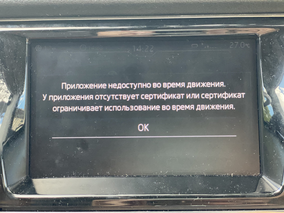

Yes - but still curious if the proximity alert actually works on the road. It didn't work for me :( - the symbols are on map but no audio alert.
I will manually add local point to the list, upload it again and perform test drive.
Well, a result of reading again all the posts around the Forum - still don't have proximity alerts/audio alerts on OEM head unit (for self made POIs). Are we any wiser this year?
Not yet :thumbsdown:.

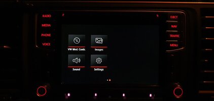

Solution with menu is easy. You have just to bring chinese firmware skin folder in device. Then you have the MIB2.5 skin with 8 tiles. Then you have tile for Car menu and you can access these menus without any diagnostic software also you have to change a value in txt file. But if you do wrong Unit is in bootloop and you`ll have to recover it.
Dear Nirvananils, i am on 478t firmware patched swdownload and swap. Also cp of. How i can put chinese skin to 478t? I have all firmware files for pq cars

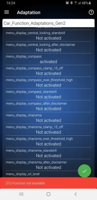

Yesterday I activated as read in upper posts but nothing happened:
Car_Function_Adaptations_Gen2-menu_display_compass – change to active
Car_Function_Adaptations_Gen2-menu_display_compass_over_threshold_high – change to active
Car_Function_List_BAP_Gen2-compass_0x15– change to active
I dont have "CAR" button so i dont know how to get to this menu?

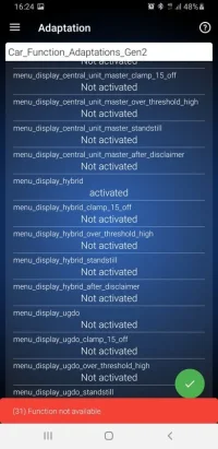

How can i transfer consumtion and offroad menu to the screen?

When i tryed to change menu to hybrid i couldnt do it...
