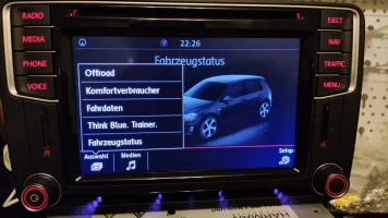

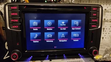

Solution with menu is easy. You have just to bring chinese firmware skin folder in device. Then you have the MIB2.5 skin with 8 tiles. Then you have tile for Car menu and you can access these menus without any diagnostic software also you have to change a value in txt file. But if you do wrong Unit is in bootloop and you`ll have to recover it.

If Iam right you just have to modify a textfile in skin folder to activate menu change without loose DAB like with chinese Skins

From searching though the Translations i saw that Fahrzeugstatus is not available in 0245
So Updating from 0245 to 0478 is not working.

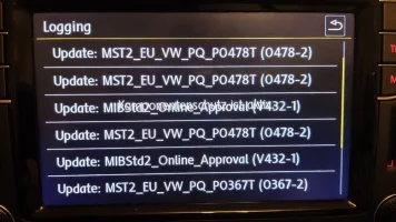

Trying smaller steps now, 0245 to 0363.
Update: 0245 to 0363, same problem

Done it with 3 Units. You can update from 02xx to 04xx! But you have to modify metainfo2.txt and swdownload to enable this.
Don`t waste your time with transfering themes from 0478 to older firm as older can't handle most of features. So only way is to update to 0478. Every Unit with train of 02xx and 03xx can update to 0478
