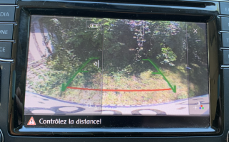

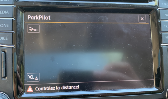

But now, I got Few problems
no more park pilot:
Capture d’écran 2022-08-07 à 15.40.33.pngCapture d’écran 2022-08-07 à 15.40.44.png

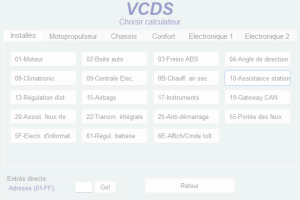

where to go in module 5F?
in VCDS, I don't see the car skin option..
sorry not module 5F, look at link below which saves me for looking at my car
I must be stupid, but I don't found where to set the correct byte for my T6...
in VCDS -> 5F -> adaptation?
in a long code?
I don't have a "37 module", or I don't understand where it is.
I trier a lot of things, and in 5F, if I change byte 0-2 to crafter, I see my park pilot
