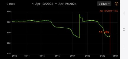

Something happened mid-morning on the 11th. Are you sure you didin't leave a light on? Door left open?
And it's happened again - has the battery had it or is it a mystery drain? Does the pattern of discharge give any clues I wonder?
That's a pretty quick drop - remind me what you've got physically connected to the battery currently?
I guess the other thing is to look for correlation around the times this happens; same time of day, same time since charged, same weather (is something getting wet in the rain and mildly shorting)?

Van has lights and dimmer, dometic crx50 fridge, usb sockets, battery status panel, dometic hob, water pump for taps. Oh and the heater but the fuse has been pulled on that for months.
Weather has been rainy for months (we live in Wales) and not decernably different at the times the discharge began. Have checked for any signs of dampness and none found, though of course much of the area with wiring is inaccessible.
1st time it happened was after just shy of 6 days and second time was just 1 day 9 hours so no correlation there. Times are different too.
Only thing different was that van had been left on hookup for 2 weeks before the first time. So battery was on charge for much longer than any time previously. I don't think any overcharging or battery damage should be possible with the Victron ip22?

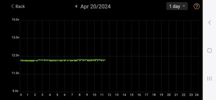

So I let it continue overnight and basically it flat lined.

It's now back on charge and I will pull the charger fuse afterwards as you suggest and monitor again.
I think there is one other item which isn't via the fuse banks - the ctek d250se. In theory, if it isn't the victron then it's this (or the battery)?
Quite honestly I was at the point where I was willing to accept that we hadn't looked after the battery and would have to replace it but these symptoms don't seem to fit that being the problem.

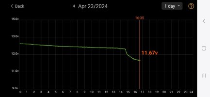

Screenshot_20240423_164143_Battery Monitor.jpgScreenshot_20240423_164230_Battery Monitor.jpg
Went out about 13:30 with all looking good then came home to find this.

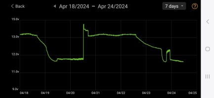

So I guess the victron charger is eliminated as the fuse was pulled. Can I pull one of the fuses from the ctek d250se to eliminate that? Will it lose any settings?

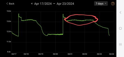

This bit of your chart, is this the van just sat on the drive, with nothing charging it? You don't have solar, right?
It shouldn't be fluctuating like that if there's no draw or charge, it should be a nice steady line with a gradual decline, like mine:
Yours looks like something is pulling a semi decent draw, which is never allowing the battery voltage to settle down, and then at a certain point it's cutting off (probably due to low voltage) which is when you're setting the drop off a cliff.
It still makes no sense though, as if there was a draw, this lowers the voltage you see, but yours goes up at times, almost like you have solar feeding a tiny charge.
Edit: actually, that wavey bit is at well over 13v, so something MUST be charging it during this. I presume the higher peaks are when you're driving?
Yes I have no solar and all the charging (including your circled timeframe) is from hookup. Each time I have tested its been by charging then removing the charge and watching what happens. I don't think the van has been started in the time frame of that graph. It's tended (as with this time) to start off with a typical discharge, slow reduction in the voltage and then dropping off a cliff and then sitting at the low level.
You make an interesting observation about the lack of straight lines which could mean something pulling power even while it's charging but I don't know what.

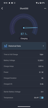

Ahh yes of course it's your leisure battery that's having the issue. I only have a BM2 on my starter battery, on my leisure battery I have a Renogy shunt so I can see precisely the draw on the battery.
This is mine at the moment with everything off (all my stuff - fridge, tap, usb ports, lights) is switched apart from the diesel heater. As you can, basically zero draw (0.01a charge).
