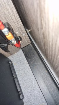

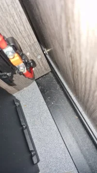

Very difficult to access this fuse but got to it and opened its case.
Now what do I do? I was expecting something removable but can't see how to remove that orange bit.
Ah thanks.
Before I saw this I unscrewed the holder from the panel behind in the hope of there being enough loose wire behind to give a bit more access but no luck. Now of course it makes it impossible to undo those nuts as the case needs holding in place.
I'm not sure it's possible to undo them anyway as basically it's blind access behind the battery. Will have another look but am a bit stumped. What size spanner do I need?
Not sure off the top of my head, might be an 8mm?
If you've got a socket set that would work, looking at your fuse it looks like the cable terminals are on top of the fuse so you'd just need to undo one of them which would release one of the cables.
Correct 8mm (or 5/16 in the case of my spanners). Got it!

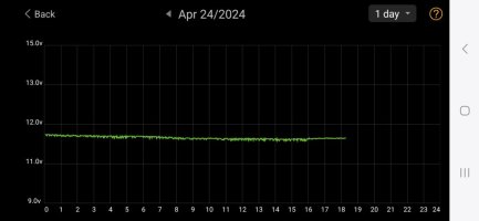

Fuse removed at about 16:00. Line afterwards looks straighter. Screenshot_20240424_181713_Battery Monitor.jpg

Fuse removed at about 16:00. Line afterwards looks straighter. View attachment 238153

Excellent, that line after you removed the fuse is looking how I'd expect it to look. The battery isn't anywhere even near full charged so I think the CTEK is definitely doing something which it shouldn't be. Whether that's faulty trickle charge function, or something else.

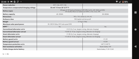

So my frustration with the 250SE manual is it covers both the commonly used 250SE and the uncommonly used SmartPass and it's not always clear which one they are talking about.
But as I read it the 250SE should only be doing a trickle charge from it's solar input:
There is another trickle charge mentioned but it's on the next page so that's actually a list of the SmartPass functions
And if you look at the list of properties at the end then trickle charge voltages are only mentioned in the right hand SmartPass column:
So best I can tell from the manual the 250SE trickle charges from solar input only
The SmartPass 120s trickle charges the starter from the leisure
I don't think you have solar input to your 250SE?
