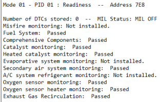

Meanwhile, you could check what the engine thinks about emission readiness.
It would be in
VCDS > OBD-II functions > Mode 1-01 Readiness > Address 7E8​
and​
VCDS > OBD-II functions > Mode 9 Vehicle Info​
Because the fault codes were cleared quite recently some of the tests running in the background might not be complete yet?
It would be in
VCDS > OBD-II functions > Mode 1-01 Readiness > Address 7E8andVCDS > OBD-II functions > Mode 9 Vehicle Info
I will take this date this evening.
Not sure about the test, lets see what i got

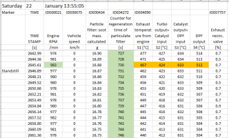

At standstill 11:23 minutes later - active DPF regeneration still in progress​
See timestamps = 2642 seconds (below) - 1959 seconds (from above) = 11 min 23 seconds
1) Elevated engine revs - idling at 980 RPM
2) Hot exhaust from engine
3) Even hotter exhaust from catalytic converter into DPF
4) DPF regeneration counter is ticking (green)
5) Soot mass calculated is decreasing

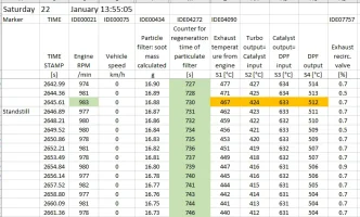

After 4:21 minutes at standstill - the ECU comes to conclusion - enough of that and starts cooling down​
See timestamp 2903.26 seconds below vs. 2642.99 above = 4 mins 21 seconds
1) EGR returns to normal'ish 30-40% closure (IDE07757)
2) Engine starts to cool down the exhaust (S1) - orange & blue bars.
3) Note a time leap - grayed out line (just to make the log fit here)
4) After 40 seconds of cooling down engine returns back to normal 830 RPM idling (green)
5) The DPF regeneration counter is paused at 989 seconds (yellow)
6) Because of still hot DPF input/output, the soot level is still slowly decreasing even during the cool down period.

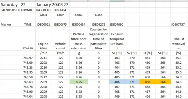

Engine startup - pending DPF regeneration​
1) Engine started - idling at 830 RPM
2) EGR at normal'ish 30-40% position
2) The DPF regeneration counter is paused at 989 seconds - non-zero=pending request
At 1:15 minutes engine has started to heat up the exhaust gases​
1) EGR is closed (no recirculation)
2) Hot engine exhaust gases
2) The DPF regeneration counter is counting again

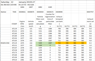

Finally - after 11:13 minutes since engine startup - the active DPF regeneration is now complete​
1) Soot level reaches 9.00 grams - active DPF regeneration turned off
2) The DPF regeneration counter is reset to "0"
Hot DPF afterheat still keeps on reducing soot level - passive DPF regeneration​
1) Hot DPF still burns soot (above soot mass calculated 8.98 grams at 674.10 seconds and below 8.26 grams at 742.97 seconds)
2) Exhaust gases have started to cool down the DPF (S3)
3) Minimum soot level reached 70 seconds after finishing active phase
