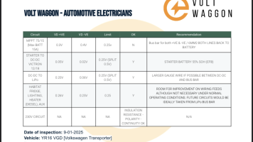

ChrisAn update for anyone interested.
Had a pleasant chap come out to look at electrics. Specialises in Vw camper electrics, owns two vans, seems knowledgable.
More from the POV of reassurance and to get his opinion on the weird dissonance in voltage numbers in my system.
Despite the shocking weather he was seemingly very thorough.
Also VERY complimentary of the guidance on this forum in guiding me on what he described as a safe install. (He described some ‘shockers’ he has seen). He was BOOSTED Solar had isolator on, so thanks guys!
Anyhow, he did loads of tests, in and out of various electrics like a ferret and will write a comprehensive report.
Main things as I understand.
-Starter battery shagged (I knew this, as AMT 12-2 has been propping up).
-increased size of positive cable to dc to dc (I used the original installed one with an inline midi fuse when I put lifepo in , he suggested too small so changed that BUT said no need for fuse there)
-suggested voltage drop is from rear cabinet (MPPT) on small gauge wire. Thinks also need to separate out systems, so has advised I fish a dual core cable for positive and negative to be closer to LB under drivers seat rather than rely on rear chassis ground. He had no wire long enough so is going to send me a link to that.
-also advised bus bar in rear from MPPT to dual core cable (I think this is what he called it).
-advised to install an isolator switch on main negative from battery too.
-one anomaly was the rear most two hab spot lights (so not main spotlights) remained on when LB was isolated. He thinks this is residual draw so has moved a cable off the positive bus bar onto the LB post. He demonstrated this had indeed worked (Solar was out of equation as a foot of snow on panels), he advised the led lights need such little power residual from starter battery would power these. Why is the starter batter powering hab lights?!?!?
This latter point raised my spider sense.
He reassured me all was safe.
His allotted two hour slot ended, he is going to send me a report with links and explanations etc and is happy to come out again if need be.
I have noticed, since his intervention. When LB isolator switched off the solar controller reads mad low voltages like 6-8 jumping around, but when isolator turned on, all goes back to normal. What’s happening here? What wire has he moved you reckon?
I’ll pull the dual core wire etc through and see if that helps the erroneous numbers but this is a new bit of info?!
Anyway, as this forum has been such a mega help, wanted to feedback on the journey
Not glow I don’t think. Like BOOOM morning!!! Lights are on, versus off. Very definitely ‘ON’. Since his change of wire the isolator on the LB does cut MPPT power (it disappears from Victron app, whereas before it stayed with 13v power when LB isolated which I wasn’t sure was correct). It’s one of the things he is going to look at.Chris
