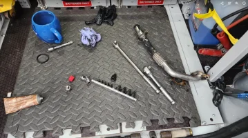

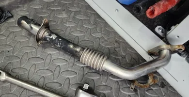

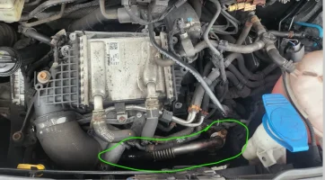

Quick look under the bonet and I found this!! Hoping its a case of just needing a new piece of egr pipe! currently waiting for RAC but not sure what they will be able to do!
