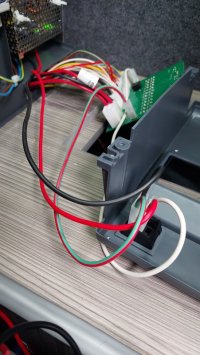

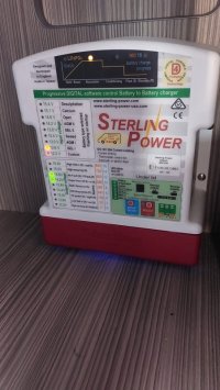

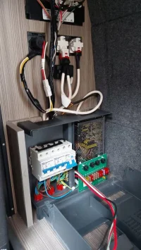

My campervan is basically three years old and I'm sure the Powerpart unit internal 12v supply has died. Checked that hookup electric is getting there, all breakers and fuses are sound, everything on the 12v system works as long as I charge the leisure battery "manually", and the Sterling BB charger seems to be behaving itself predictably (ie now reporting 12v input is low when on hookup, which I understand is from the Powerpart's 12v internal unit which I think is the issue)
Question is: I've seen listings of what look almost the same thing (ie Powerpart PDU), but say "new version" in the details... but are these new versions a straight swap out? ie, disconnect all the plugs, remove unit, put new one in, reconnect the harness plugs?
