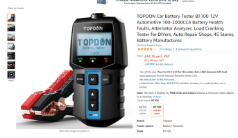

To test the battery for SOH & SOC you need more than a meter and BM2.
i use one of these Battery Tester meters:
They work on all SLA battery's (not lithium though)
