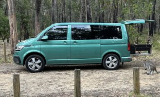

Many thanks for the reply! I've been in contact with Toperformance, and have pricing on Koni Active dampers. Trying to determine if i can use the original springs all round, or just go for new front springs to get rid of the weird look from the front sitting higher than rear. Pic enclosed to demonstrate this (skippy for scale ;)).
Would be great to hear from other owners who have gone for Koni shocks and eibach springs or std springs - might search the forum separately.
You can just fit a 30 to40 mm front lowering spring. BUT don’t fit the rears it will go too low and special active won’t work.
this is the mistake most camper converters make here in uk , they ride terrible !
Thanks again! I think this set of front springs could be just what i am after? Eibach Springs Volkswagen T6.1 CALIFORNIA (SGF, SGM, SGN)
Toperformance is concerned about the Special Active dampers used with lowered springs being outside of their operating range. I would think 30mm front drop is fine for those shocks, and leave OEM rear springs?
They are correct that’s why I said 30 to 40 max. Unfortunately many after market springs don’t do what they say on the tin must measure the wheel arch gaps carefully. Active shock is ok up to 40 mm we haven’t had any issues
