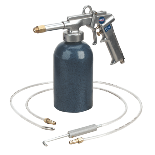

I'll second Bilt Hambers Dynax line, If you have access to a compressor, you can pick up a spray gun for around £60.
Buying the wax in the 5 litre jugs is the cheapest way to do it.
