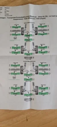

Just had 4 wheel alignment done after having 2 new tyres fitted yesterday and also having had new shocks fitted at start of year.
However, the steering wheel is off centre. I've been back to my garage where I've always gone for tyres and alignment and they have adjusted it firstly under partial load and then no load.
All was adjusted and in tolerance, but the problem remains with the steering wheel off centre. I've attached the print out of my visit back to the garage from this morning, in the hope of any solutions. The figures listed on the right in blue are what the settings are now.
Thanks all.

I've just looked at your original post. I can't quite see what the corrected front toe values are right to left. If there is a difference between these two values? That's the problem right there!!
If the steering wheel is set straight ahead when those measurements were taken then the toe values should be equal. Or very close.
Consider the variation between the half toe figure as a percentage.

The alignment was slightly out and so was adjusted to bring everything back into levels. I've also just been to another garage where they use a Hunter Machine, with the levels in the photo. The tech guy said all was good, test drove and could see for himself the steering was off. Adjusted again and problem still remains. Could it be suspension related?

It’s a bit odd the Rh Rear has 13' of toe & the Lh has 0. Lh front has much less camber than the Rh? But it's within the tolerance allowed by the wheel alignment equipment.
