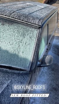

C rail fitted to roof. Had to re stick the rear end due to not prepping the rail bottom for the sika flex
