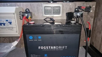

This is what it all looks like at the moment.
20240521_171759.jpgBTW those covers on the joining boxes are a pig to get open hence I'm not shutting them till last minute.
I'm seeing mention of rubber covers for under seat fittings. Could I just knock something up from a sheet of rubber to go over the top of the battery and a few cm down each side?

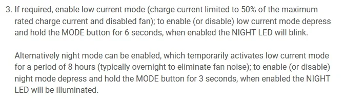

Not sure which IP22 you went for but on the assumption it was the 15A the simplest way is to enable the low current (50%) mode straight from the charger (you can probably do it in the app too) rather than setting up custom charging
Knowing where night mode is will be useful for when you use the van BTW - means the charger will take it easy for 8 hours and be less noisy :thumbsup:

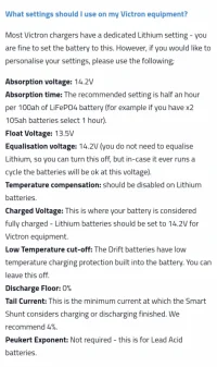

The default Victron lithium profile is fine, it should be 14.2v absorption and 13.8v float.
Remember, in the bulk stage the voltage will rise as the battery charges. 14.2v is the 'full' voltage, which is what the end of the bulk and absorption stages is aiming to get to. Then once it's full it'll reduce the voltage to 13.5v.
