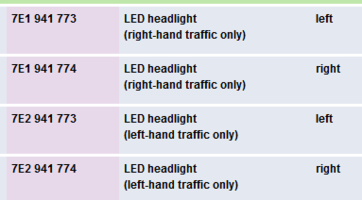

Keep in mind if you buy genuine LED lights from TPS, they DO NOT come with the LED modules which are needed. Each headlight has two. If buying off eBay, make sure they can be seen fitted in the photos, you may bag a bargain.
Non of these part numbers come with the modules from VW ( unless they are previously enjoyed lights off eBay or from a scrap yard.
You will have to order them separately.

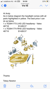

I did ask a quote from local vw for this headlights
But here in Australia they did ask aprox 1500£…..
Yup, they are not cheap. They will not work without the additional modules numbered 7 and 11, you also need to order the retaining screws looks like No.18 but haven’t got my glasses on.
