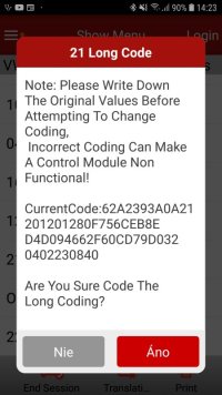

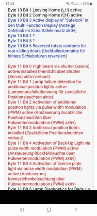

Dobry den, chcem sa podakovat vsetkym clenom fora, menil som svetla aj na mojom multivane T6, z H4 na Led, mal som aj DTC, pomohlo mi kodovanie byte 18-66 bixenon svetla, byte 11 bit 0 dialkove svetlo aktivácia xenónu.Screenshot_20221118_145238_Chrome.jpgScreenshot_20221118-142317_X-DIAG PRO3.jpgScreenshot_20221118-142348_X-DIAG PRO3.jpg20221118_142439.jpg
Good day, I want to thank all the members of the forum, I also changed the lights on my T6 multivan, from H4 to Led, I also had a DTC, it helped me to code byte 18-66 bixenon lights, byte 11 bit 0 main beam xenon activation.
