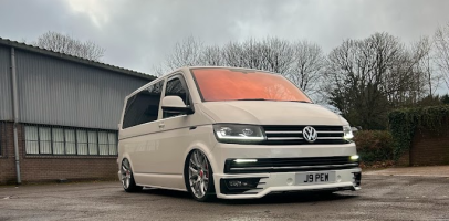

Finished fitting mine today. Loads of traffic and no flashes from blinded drivers. Easily passed 100 cars.
No warning lights on the dash and now I can see. Happy days

where's ya pics?
I still need to build the highline style bumper. I have a feeling there's some smashing and plastic welding going to happen, as I got some foglights and there's not a lot going on behind my new bumper for attaching them.
