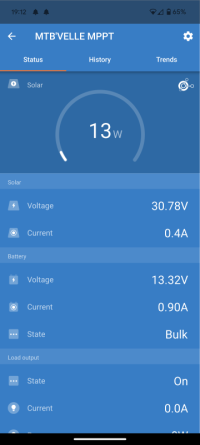

First thing to check, yes it works!
It's a Victron 305w rigid panel, this is in basically full shade (a sliver of panel in the sun) and the sun 2hrs away from sunset.
So that's all good.

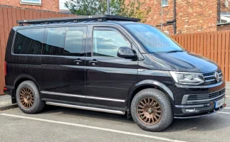

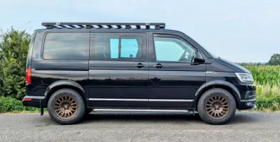

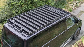

I've been having thoughts about getting a full size roof rack for a while now, and this has pushed me over the top on the decision.
Not only would a roof rack let me mount a rigid panel in about 20 minutes with just 6x bolted brackets, no glueing or bonding - and change panels if I want a different size or combination - it'll give me some much needed extra storage space, and also give me the option of fitting a roof tent if/when I come to want more sleeping space, without having to pay £5k+ for a pop top to be fitted. I'll also be able to mount an awning, led light bars, etc etc.
And as a bonus, it'll add to the "swamper" look that I'm going to be aiming for with an upgrade of wheels/tyres and suspension!
I'll need to get rid of the Fiamma F40 Van that's currently fitted as it uses 2x of the roof bar mounting points. I'll look at a replacement awning at a later date.
