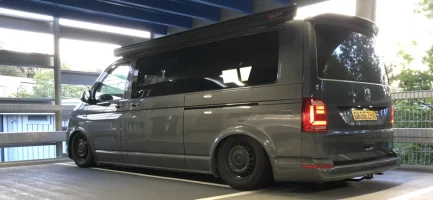

Welcome to team air. looks awesome mate, the colour combo is class. I just wish I had had the time to do mine myself.
Have you had it re-aligned and if so where and what settings did you go with.
Thanks for the welcome. It wasn’t my first choice of colour when I was searching for a van and made picking wheels a bit more limited, however I don’t think I would change it now.
I think the wheels on yours are really nice.
Not had it aligned yet, I’ve not had time to experiment with ride heights yet to decide the main height it will do most driving at.
