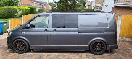

Hello Chaps and Chapesses
I hope that you can help me
I've recently bought this beauty which is a T32 204 DSG 4motion that I believe has Bilstein B14 Coilovers fitted which while I find the stance very appealing to the eye, we tow a 2 ton caravan as well as this being my daily driver it worries me that without any load the tow ball is already on the lower recommended limit... therefore I am considering going down the air route
I hope that you peeps can give me some advice... I am running Judd 311r's with 275/35 tyres
Aims
Retain the existing ride height for day to day use
Self-leveling when loaded
Raise the ride height for towing and bumpy campsites... nothing extreme
Lowering for car park entry
Any advice and recommendation would be great regarding comfort, wheel sizes, different systems plusses minuses etc would be most welcome... I've looked at airride but they just sent me links to their website and the other I've looked at was VB but am a little concerned about how low it would go to retain the existing look... Please help

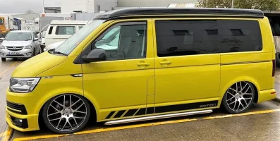

Problem may be those type of tyres if you aired out but here’s a example of it up and down on the same wheels, think it could have went higher... will try get a pic later.

Thanks, that first one looks as high as I‘d need. I’d sacrifice the tyres if necessary and go for a halfway house like the Latitude Cross or Nokian Weatherproof You have the exact setup I was going to go for, but you’re not happy with it? Is it because it doesn’t go low enough or something else I should be concerned about?
