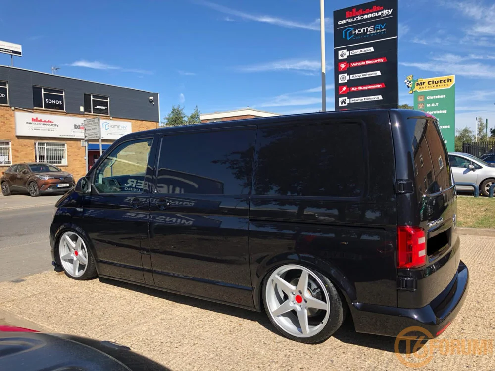

Lads I am considering to join this team.
I have T30 Caravelle on 19" rims and 275/40R19 tyres.
Can you convince/motivate me?

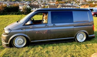

That's mine on 245/45/19 with no extra mods. If I want to get it lower I will have to start chopping some of the front arch out behind the front wing. Obviously the easiest thing to do would be change the tyre size so I hit an overall 27"
The picture on page 3 with my steel wheels on hit the 27" diameter and the van sits lower and can almost roll aired out.
I think you will need to change your tyres.
I love having a low van and then being able to raise it when I go off road or over a major speed bump.
