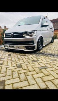

What the et which might be the biggest factor? I have 9j et35 and don’t stick out.. had some Detroit Steels that stuck out like these..

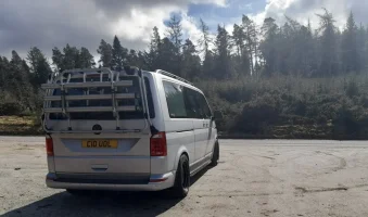

I don't think the bulky tyre is helping. I've found another set same set up from earlier in this thread and they look to sit the same so I'm 99% sure they are 9in.

That’s my van, they were 9” & 9.5” rear, this had some mega chunky winter tyres, and my van was only on H&R lowering springs at the time, looked a lot different when I changed the suspension for SoLow and tyres, never had any issues.
They definitely look 9's on the front I ran a set of 9 front 9.5 rear

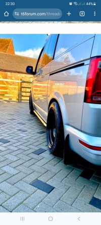

My Duchy 9.5s just rubbed my sliding door card ever so slightly
Thanks guys, I will put them on and see. Wont be going lower than I am now so will try with new tyres.
Yeah rears rub on the door, mine is a shuttle so wider door cards. I've had the 9.5in rear before, it kind of helped so the kids didnt slam the door open.

Put the wheels on and went for a drive. No rubbing and I'm getting more used to it. Tyres need changed so maybe get something I know fits well. Colour will be changed as well.

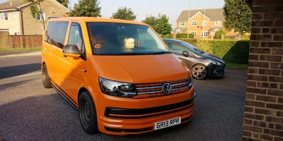

Anyone in the Manchester area / North West running banded Amaroks in 9 / 9.5J who wouldnt mind me coming having a look at how far the poke?

I have a post on here (could be anywhere, search for sliding door or touch) somewhere with a picture taken along the side of the van

John, I'm running banded Amaroks and only based in Eccles if you want to pop round
