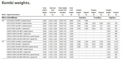

In my research you are safe to claim the vat back on a T32 SWB combi DSG as it a payload of 1000kg (1112kg my combi). As i understand it as long as you have the magic ton payload you are fine for a reclaim. I think i am right in saying when you add 4 motion it drops just below the 1000kg (966kg).
Does that then mean that adding 4motion means I can't claim the VAT back? That option becomes slightly more expensive then, by around £7k.
Absolute cure for insomnia all of this, most of my time off has been spent back and forwards to dealers and research / this forum. Would be completely lost without this forum.
Just checked the brochure tech yet again and your right on the payload weights;
SWB Highline Kombi 204ps 6-sp manual 4motion = 986kg
SWB Highline Kombi 204ps DSG 4motion = 966kg
If I want 4motion it can only be a 150ps manual. 1014kg payload.
I cannot have 4motion and DSG by 34kg. Can't VW just make the figures up to make life easier in the short term....

@Smiffy At great risk of causing offence you could read the July 2016 brochure. My understanding of what has gone before is that a Kombi LWB T32 4Motion DSG has a load capacity of under 1t so is exempt from VAT refund and as a Kombi (a van) it will be classed as N1 and subject to speed limits of 50/60/70. I hope that is clear enough for you.:sleep:
Close... but N1 isn't the procluding factor, the unladen weight will be. I'm pretty sure (from memory) that any LWB DSG is over the 2040kg unladen hence it's out of scope for being dual purpose..

That's what made got me thinking with the 4motion aspect of it but looking online it's unladen weight is 2297kg so that puts it over anyway
