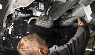

2) Here, the reseller's technician seems to move back the fuel tank to drive some air lines or sensor cables behind it. It's more secure, but not sure that all reseller's technician will do it.
=> Is it a mandatory request of the VW certification?
=> Is there a VW tracking sheet that reseller's technician must follow?
=> In the followed thread we saw that VB Air Pump for Suspension has been connected directly to battery's negative. Is it correct? Not sure...
