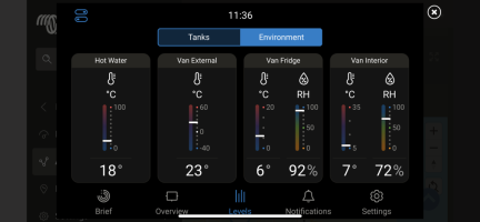

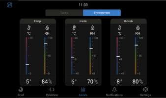

I thought it was about time i added the other RUUVI temp sensors, to the Cerbo GX-S in the Bus,
now one stuck to the LB,
one for Outside temp
one for Inside Temp.
its super easy to add devices now with the New GUI, . . . .
How do you get this Ruuvi display? I don't see that. Is it an Android vs iOS thing? Can't see how to get it on the web VRM either.
