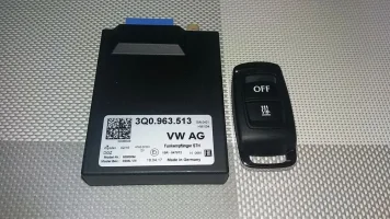

Changed the software of the control unit Webasto. No ceiling timer. The heater is started from the universal remote Webasto Т91. I want to run it from the remote transmitter 3Q0 963 513. Is that possible? If Yes how?
Is this the same as your remote control
Exactly the same. I heard that it is possible to run the heater from the OEM remote T91lin from VW T6. Do you have such information?
I tried. It doesn't work for me(. May need some additional coding VCDS? The signal protocols of these consoles are different.
