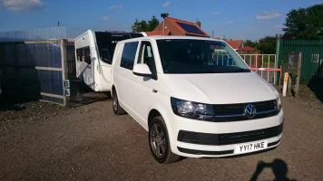

Hey guys
I'e Just received my westfelia detachable tow bar. Most detachable ones I've had in the past has the electrics plug that flips up and out of sight when you don't want to see it. However this one looks fixed. Can you see the electric socket all the time if that's the case? Seems a bit pointless bothering with a removable tow bar if that's the case..hmmm
Cheers Paul
It sits low and slightly back so although it's permanent it's not overly noticeable will run out and take a pic
Here you go, it's dark and raining but should give you an idea, the plug sits levelish with the mounting point for the detachable bar
Top man Pauly thanks.
