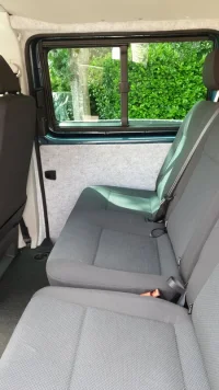

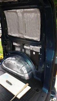

Finally got the sliding full length bed upholstered. Side cupboards installed. Under bed cooker and fridge to be installed this week, along with leisure battery and electrical system.
The front leather seats are with the upholsterer, so hopefully they will be fitted by the end of the week.
