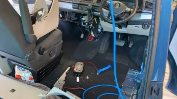

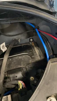

Looks familiar! After fitting my tow bar at the weekend I found some time to start the wiring.
EHU, 30A feed wire and a spare 30A feed (capped) for future proofing as there was a spare terminal in the E-box.
I haven't decided which seat to bury it under yet...
Mine will only go under the drivers seat, not sure what options it relates to, but there is a mountain of wiring under the passenger seat, so no chance anything like battery is going under there, just the inverter
I only have a couple of small relays under the passenger seat so loads of room on both sides. I need to power the tow bar so will need a 12v feed under the passenger seat anyway (I didn't like the wiring to the battery that PFJones supplied). I am not fitting a leisure battery straight away so i may have to change it around once I see how much room it requires.
