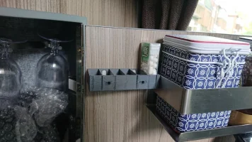

Installed this:
Used 3M double-sided adhesive tape rather than the screws, so it is back-to-front, as the front is smoother.
Just have to eat 6 boxes of Tic-Tacs now :laugh:
