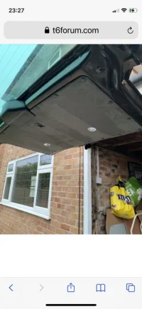

Don’t you have a tailgate as an up-and-over garage door then?!!View attachment 100326Why isn’t that attached to a van. Not normal that isn’t.![]()
